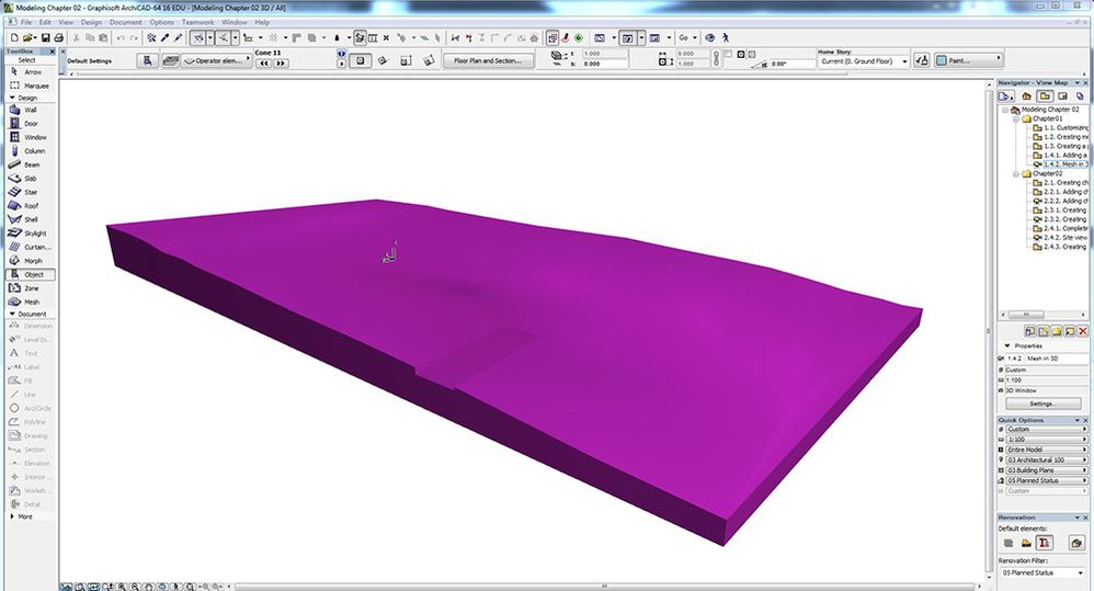

I'm completing the Advanced Modelling tutorials in ArchiCAD16 and have run into a problem with the display of the project.
The project displays in the purple colour as per the attached image. I've tried other chapters with the same result. The same display appears in sections, elevations and plans.
Can anyone help me resolve this?

martysoccer:
One thing to check is the Renovation Filers > Renovation Override Styles > Material; there may be a material override on the elements.
David

Nailed it David - thank you.
