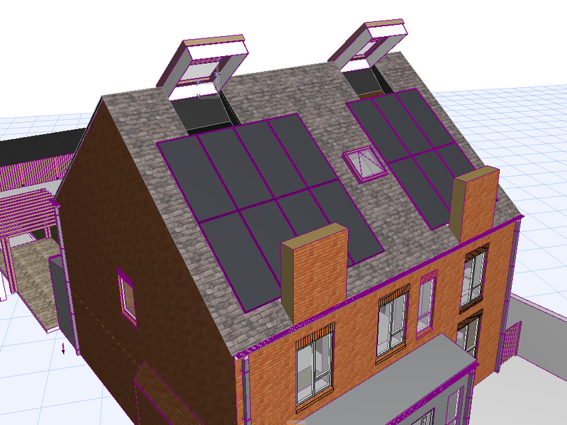

Hi All,
I am having an issue where our architectural model looks different when hotlinked in to our structural model.
I have checked story settings, composites, deleting anything far from origin & wall linking but cant seem to make ground on fixing the problem, has anyone experienced this problem before?
The architectural model was made by our sister office that has a lot less experience with ArchiCAD than we do, I didn't know if they have changed a setting that is causing this as I have never come across this before after 8 years of working with ArchiCAD.
Pictures Attached.
Thanks

The bulk of the model looks fine.
It just seems to be those 2 larger skylights.
What is different about those compared to the 2 smaller ones?

Your storey settings are the same between the hotlink and host file? Though in the hotlink settings, you can set it to retain the original storey heights.
