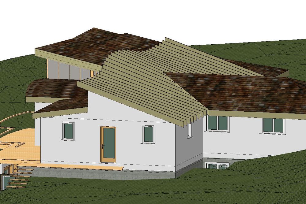

I'm trying to figure out how to model this curved roof. I'm a new user and just modelled each rafter to get a sense of it first. The plate height is consistent at the bottom wall but each rafter has a different pitch. Any tips?

Ryan,
I think I am starting to sound like a stuck record
but I would suggest the mesh tool.
From your image, you seem to know how to use the mesh tool.
Post back if you need more detail.

TomWaltz wrote:
Just out of curiosity, how do you dimension a roof like that?
Don't know yet Tom. I'll give them a constant plate height at the base, a constant plate height at an intermediate wall that snakes through the inside of the building, and a bottle of Jack.
Sorry if I missed your previous posts about meshes Peter. I'll give that a shot. Thanks!

I think I am starting to sound like a stuck record but I would suggest the mesh tool.
I agree with Peter...I agree with Peter...I agree with Peter...I agree with Peter...
BTW - He was referring to a different post:
http://archicad-talk.graphisoft.com/viewtopic.php?t=10681
Cheers,
Link.
Just to make sure I modeled this type of roof
using the mesh tool. Once I figured out how
to get the elevations of the edge nodes graphically
it was relatively easy.
