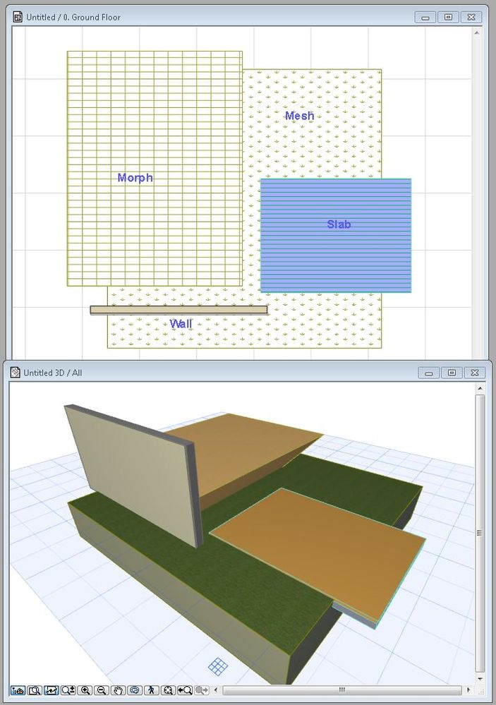

I have a number of morphs that I would like to "cover" over some meshes that have their own cover fills. No matter what MVO I use I can't get the morphs to appear with a background fill? Whereas my ordinary walls work fine.
Anyone had the same issue?

not really, Why is it doing that?

Maybe your Morph is cut by the Floor Plan Cutting Plane so you do not see its top and the cover fill either.

Got to the bottom of it.
Thanks Laszio for the Floor Plan Cutting height reminder as that solved it for most of them but the other thing I hadn't realised was that some of the morphs were set to "Overhead all"
