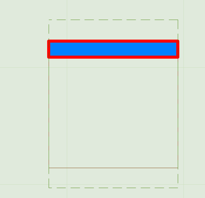

see attached explanation image.

How it looks in floor plan

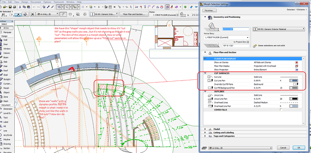

Eduardo Rolon
then select "Convert to Morph" and once you open its settings this is what you are looking for. If it does not say "All selections are solid" then you will need to retry.

Eduardo Rolon
Edit settings to taste.
