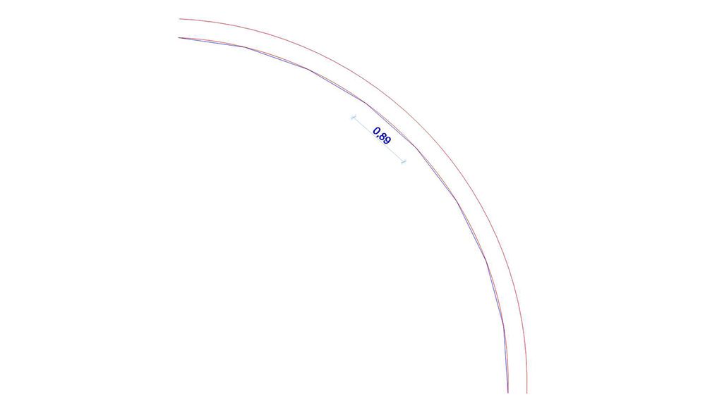

Hello,
I've noticed that when I try to create curved shapes with the morph tools,
the shape that I am getting needs more "steps" (in lack of better term)
I tried changing the settings in the magic wand tool or even doing the curve by hand, but no luck.
I am attaching a picture to give you a better understanding.
The dimension is in meters.
Thank you.

Anestis:
Try this: select the Morph and use the command Modify Segmentation...
David
David Maudlin / Architect
www.davidmaudlin.com
Digital Architecture
Thank you for the reply,
it did the trick!
