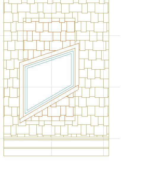

I have a problem when using the Mouldings and Panels with W Slanted Fix Window. The window is called the " !!! W Slanted Fix 81 USA !!! " in the window objects Master Script. The wall hole for this window is a large Rectangular hole. See attached.[/img]
3 REPLIES 3
A Solution is to give the "background" wall the same material specification as the upper wainscot. See Attachment
The materials do not "line-up" though.
This is not a solution if the break in the Wainscot happen halfway or so up the window.
Here is the Actual Section Elevation view with the material I am using.
Not too bad. But still would not be good if the wainscot started somewhere within the window height.
