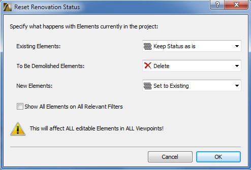

BHuttman wrote:If you save each phase as a new model then it can be done.
Does anyone know how I can setup multi-phase projects in ArchiCad 17? Some of our projects may require 3 or 4 design/construction phases within a single project. Can the Renovation Filters be used in an effective way so that we can display Phase 1, Phase 2, Phase 3..... each with their own set of demolition and new elements?
