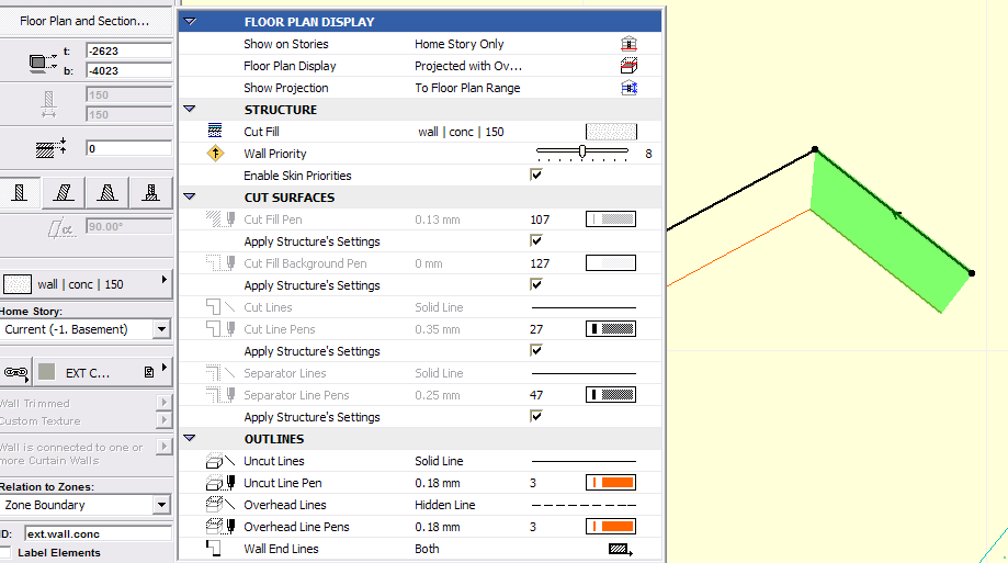

Despite having "Floor Plan and Section > Wall end lines" set to "Both", I'm missing the end line on this uncut wall in a view.
Any ideas as to why, and how to show it?

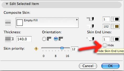

Is it a Composite wall? Check you don't have Skin End Lines set to Hide in the composite's settings.
Brilliant, Stuart - That was it! It was a composite - an existing one that I'd modified - so it was obviously set to "hide" from the previous definition. I hadn't noticed that you could set the end line behaviour from the composite - something learn't from the forums, yet again! So many thanks for the suggestion

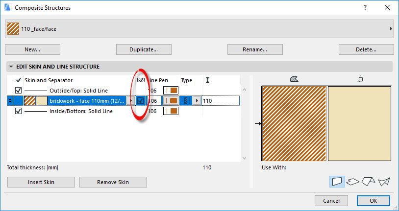

sorry maybe it sounds silly,i am new archicad user. but where is that dialog box you attached is located? i cant found it. i use archicad 20
David Maudlin
Rockstar
galih sabdo aji:
That post is from 7 years ago, so the interface has changed. In the Composite Structures dialog box, the 3rd from left column has a check box for showing/hiding the end line of each skin. In the Help files see:User Interface Reference > Dialog Boxes > Composite Structures Dialog Box.
David
David Maudlin / Architect
www.davidmaudlin.com
Digital Architecture
AC29 USA Perpetual • Mac mini M4 Pro OSX15 | 64 gb ram • MacBook Pro M3 Pro | 36 gb ram OSX14
This is it in V20.
