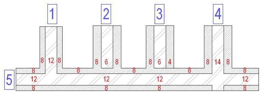

Hi the priority works like this:
In the picture below the red numbers are the priority of each skin within the composite wall.
In no. 1:
All the skins has the same priorities, thus they interact with each other.
In no 2:
The side skins have the same priority being 8, so they interact with each other. However the centre skin has a lower priority (6) than the side skin of wall 5, thus it does not interact with the skin.
In no 3:
only one skin has the same priority so it interacts the other two has a priority lower than the 8 so it does not interact.
In no 4:
the two side skins interact as they have the same priority but the center one has a higher priority than both the centre and side skins of wall 5 thus it over reacts on all of them.
hope you understand what i mean.

what a great graphic! I haven't had to get into modifying priorities, but I'll referencing this when I do.
R Muller
Wow, Cecelia, your illustration is just what I wanted! I hope Graphisoft picks it up and puts it in their manual.
