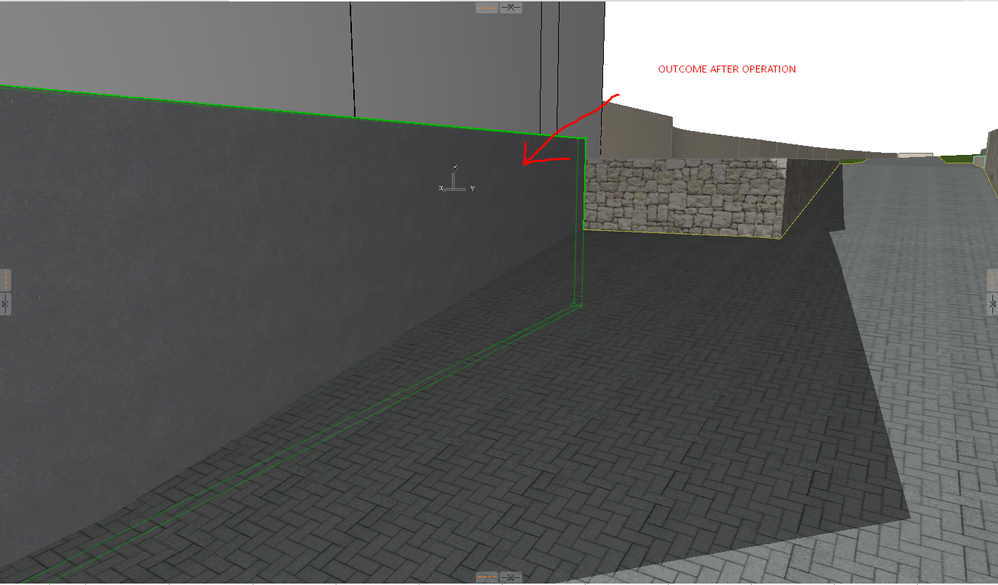

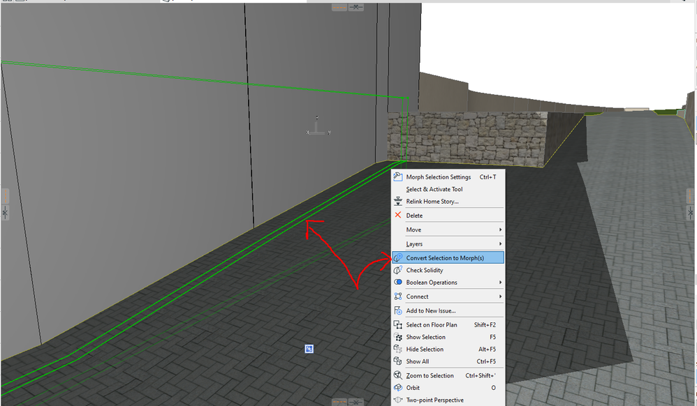

I have a wall mesh that im trying to convert to morph after an intersection operation with a terrain.
After i choose "convert to morph" the terrain goes back to its original shape. I have seen tutorials doing this and this outcome not happening. What am i missing?
BTW, i am trying to design a kerb that follows the terrain slope.
Thanks

I just worked out how to make the morph from a mesh (ArchiCAD 27);
1. Select the morph tool
2. Magic wand all faces of the mesh so that you convert each face to a morph.
3. Turn off the mesh layer, select all of the faces to the 3D volume you need.
4. Right Click the selection and do either;
(a) "check solidity" (then if it gives the option) tell it to "make solid", or
(b) "Boolean Operations">"Union"
There you have it!

Glad you found a way!
But im guessing that is a workaround to a problem, and i was looking for what is the cause of the actual problem, because having seen the operation be made in a simplier way makes me wanna know what is happening wrong. I am looking for speed and efficiency while using archicad.

You could also create a more detailled kerb with a complexprofiel as a beam or with the railing tool.
