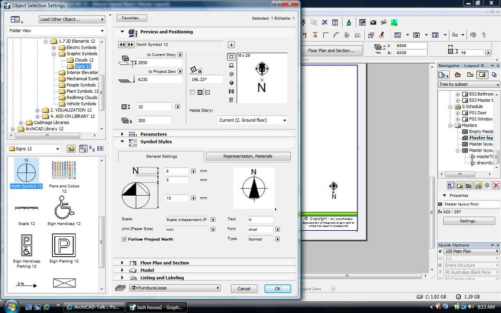

if you want the north marker to show its true orietation on the plans, then goto:
View>3d view mode>3d projection settings>more sun
from there change the project north marker to the required angle.
then goto your master layout you use for plans and add a north marker. and make sure you tick the box 'follow project north'
master layout> north marker is orientated as set. hopefully
