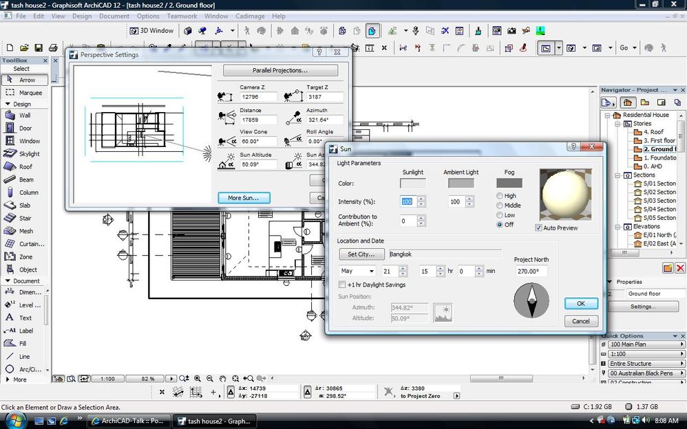

if you want the north marker to show its true orietation on the plans, then goto:
View>3d view mode>3d projection settings>more sun
from there change the project north marker to the required angle.
then goto your master layout you use for plans and add a north marker. and make sure you tick the box 'follow project north'
master layout> north marker is orientated as set. hopefully

Views do not automatically identify themselves relative to project north. (It is possible to make a GDL marker that changes its name ... but that would not change the view name.)
The name is a manual setting. If you have pre-placed S/E/N/W elevation markers and they do not orient to where you have placed project north, then simply select all four markers and rotate them to get them where they belong. Easier than re-naming...
