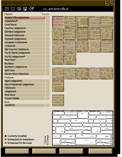

You could download StoneCad.
It has 20 or so seamless stone fill patterns.
