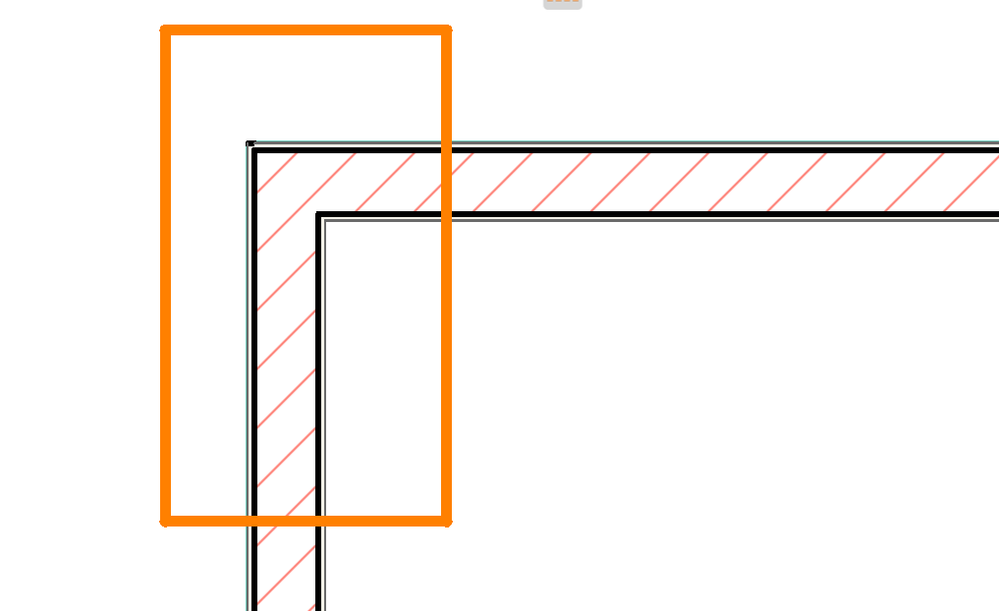

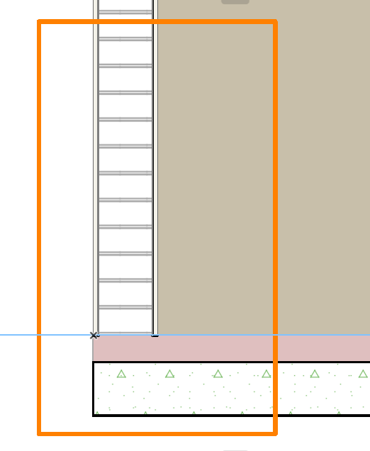

This is possible or not to Create a Pattern wall in plan difference with section.
Refer to image 1(wall plan)  is use diagonal. And Section i would like to change pattern to Horizontal double line.

You can achieve your desired representation by using graphic overrides. Basically, you tell Archicad to replace, in sections or any desired views, all the wall cut fills with a different cut fill. You can have different fill colors etc.
More on that here: https://help.graphisoft.com/AC/24/int/_AC24_Help/050_ViewsVB/050_ViewsVB-134.htm

But keep in mind that Graphic Overrides always affect the whole element. In case of Composite Structures and Complex Profiles, that can lead to unexpected results, like your example where all three skins of the Composite will be overridden with the spacified fill.
