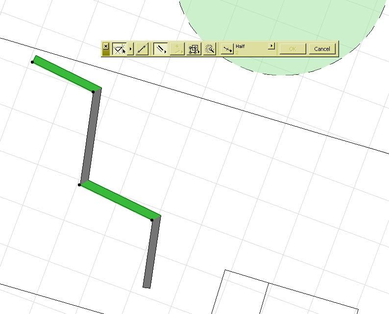

1. You could split the buildings into 2 hotlinks(pln) according to the 2 different coordinate system , bring them both into the master plan - which can be a 3rd different x-y coord. with all the drawn info excluding your buildings.Using the great tracing tools offered by ArchiCAD , you can set up a layout drawing of the master(site) plan - you can do this for each floor if you like - and bring it into your 2 hotlinks ,setting it up as a tracing reference.It means you can avoid having to use too many hotlinks , it automatically updates (no problem that it's sourced from another drawing) when changes are made to the master plan and speeds up your work as you deal with smaller files.This way you can have any number of different coord. systems merged.
2.If you are in an advanced stage of the project , probably a good and simple option is to set your grid to one of the two x-y direction and use the "paralell" tool of the control box to be able to repeat your specific direction quickly ,any number of times. I know it means 1 extra click in between the segments , but keeping your palette in the right position it takes only 0.3 s (much quicker than waiting for guidelines).
