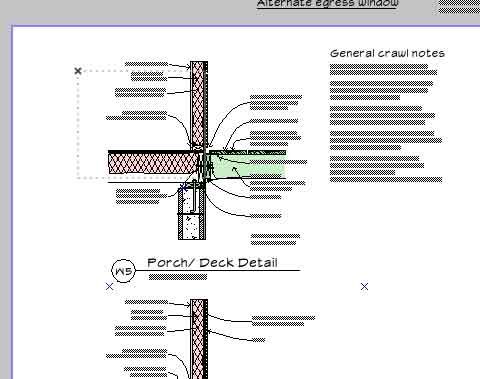

I am on a new computer (intel w/ ATI 2600 (with a bad reputation)) and just started having a consistent freezing of AC.. many times. If I select drawings on a sheet with the arrow by click and dragging AC hangs (see picture as to how far it goes before locking). That does not happen except on a sheet with placed drawings. It might eventually clear, but not for long. I opened many PLN's and while it was not completely consistent, it was with most. I restarted the computer several times, let it cool (incase it was the video card), but I was getting the same behavior, until I updated the external drawing (they are Absolute Path and Manual update). After that I have not had that issue. The drawings don't stay linked, they revert to a warning yellow triangle, but it stops crashing AC.

We have seen this in two disguises:
1. Freeze on drag - was a library problem as per DVH's posting. Reinstalled the library & no more problem.
2. Hang on drag - the Mac swirly wheel which went on ad-infinitum.
Was probably a network lookup / permissions problem- we altered our server HDDs and started getting lots of afp errors related to network paths.
There also appeared to be library permissions errors where certain libraries weren't available to load over the network & other curiosities. The drawing drag hang appeared at the same time.
We never really got to the bottom of 2. An subsequent upgrade to OSX 10.4.6 on all the machines made the problem go away.

Rick, I was having almost the exact problems on PC, but also hanging on the panning while in views, a lot!!
My IT son called it potentially "memory leaking". Program not letting go of memory when it's suppose to, even with the 4gigs you have, it can eventually fill up. One thing is to not close the views with red X but with ctr W (top bar window tab) that really helped a lot. Also using ctr alt del will show you memory available, which I'm guessing you already knew, but that graphicly showed me the memory usage was continuing to rise the longer I had AC open. But sometimes I had to close views by Ctr W, then close AC and reboot PC to clear all the way. It got better with build 1114 and with memory management I have it under control even on my old machine of only 1.8 and 1 gig! and basic video , (non approved).
