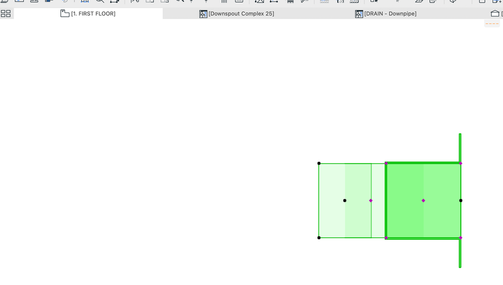

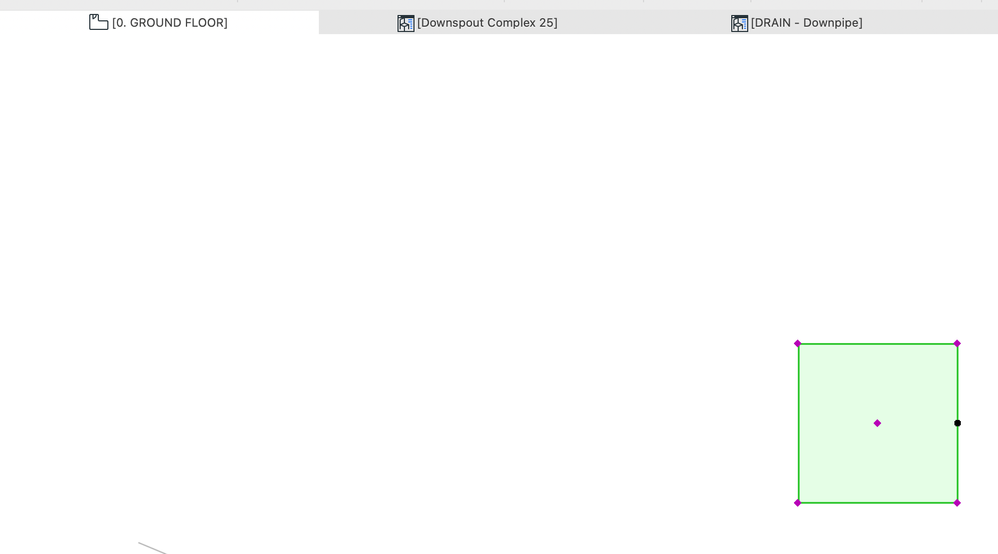

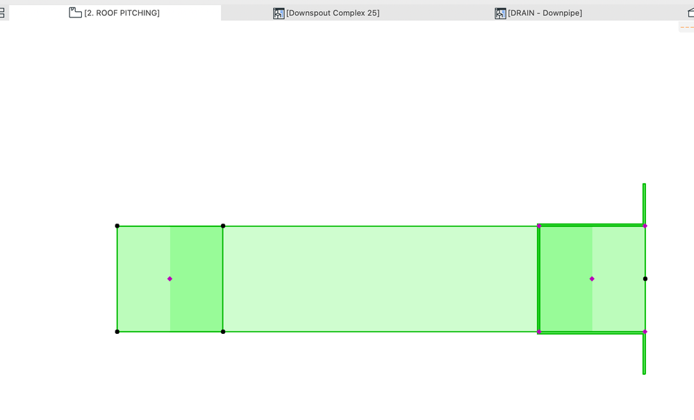

There is method to script object to look different on different stories. Check object Downspout Complex 25 from default Archicad 25 library
You can also add script changing the plan view according to MVO Lighting and HVAC Floor Plan Symbol, or add your own MVO settings. This way you can have absolute control over object view on plan according to story and type of plan. Sounds complicated but it is not.
