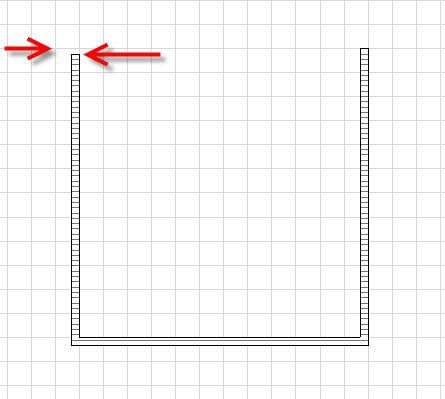

Stress wrote:I know how to do this, but when it snaps it to the 11'9 it is off the grid.
1. Make sure your "Coordinates" pallete is displayed.
2. I assume your drawing with the line tool set to "Draw a rectangle".
3. Click mouse at your selected begin point and start "dragging a rectangle".
4. Hit the X key and type in 11-9.
5. Hit the Y key and type in 12.
6. Hit return...... How'd that work?
How do I line the grid back up with the wall?
Or can I?
2005-04-23 12:49 AM
home_builder wrote:If your grig is set to 1'x1' and you're settings are set to snap to that particular grid, then that's what happens. Unsnap to that grid, maybe be wild... turn snap completely off... and try it.Stress wrote:
Or can I?
