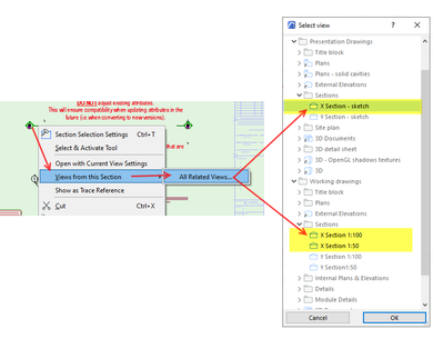

When opening the section views from the plan or details from the section, it will open with current view settings of the floor plan.  Is there a way to change that setting to actually open with the correct setting those sections already have implemented? Or is it best practice to always open them from the View Map?

There can be infinite views from one marker... so which one should open?
If you need a specific one, you should open it from the view map.
You can however link a marker to the first on a layout placed view (of said marker view). This might be something you could use?!
sknsnw9
Well, I guess what I'm trying to do is just right click the section on the plan and open it that way instead of scrolling through the view map to find that specific section.  But when I right click, the only option I get is "open with current view setting" which is the floor plan which I do not want.  I rather open it that already has the settings associated with that section.
As runxel said, you may have one view for your section or you may have three views saved with different settings.
Which one should open?
Not quite - try this.
Right click on the section.
Choose 'Views from this section' > 'All related views'.
You will get a list and only those related views will be selectable.
It is the same list you would see in the navigator, but only the related views can be selected and they will show with darker text.

Duh, I completely overlooked that "Views from this Section".  I do get the list that's related to that section.
Learned something new that you can use the same section for more than one views.  Thanks Barry and Lingwiser and Runxel

I don't get a list for some reason.
I have to click 'All related views'.
I wonder why?
That was in 25 but I checked in 22 and it is the same for me.
Also checked default template in 25 and still the same.
Might have to do some investigating. 🔍
That seems to be a 'recently opened' views list.
If I open a view then it will show in that list.
You can close the view and it will still show in that list.
But they don't show in the list until you have actually opened it.
