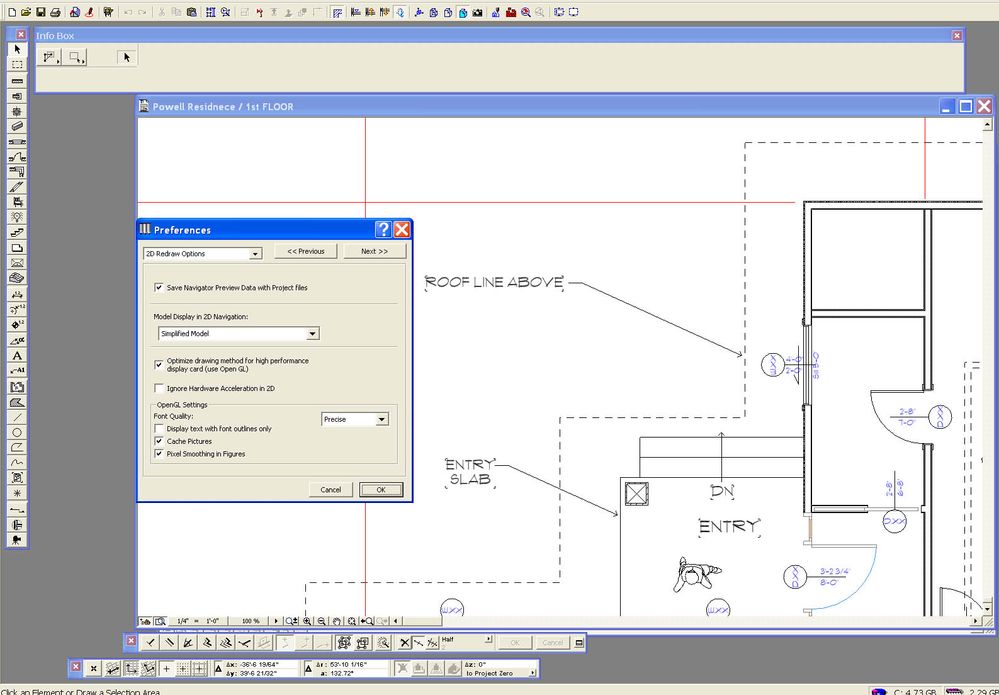

I've recently installed a matrox parhelia 256 graphics card. Once the card was installed I figured that I could change the Preferences/2D Redraw Options to Optimize for high performance display card. Once I changed the setting the fills on the project were shown as solid black. The card works OK in other respects.
Is this a bug or a problem with the card?
For now I'm just deselecting the optimization option off.

with optomization ON
This setting also makes the text look odd.

It seems that a variety of cards don't work properly with 2D OpenGL enabled. Yours may be one of them. Even though you just installed it, the manuf may have a newer driver on their web site ... check there and see if that makes any difference.
With my ATI 9700 Pro, the most recent drivers are less flakey in 2D than last fall's ... but 2D OpenGL is still nearly completely unusable. 3D all works well though.
It's the card/driver and not Graphisoft AFAIK.

Karl,
Thank you for pointing me to the solution to the problem with the fills filling in (solid black). I installed the Pahellia's latest driver and updated to ArchiCAD 8.1 r2 at the same time so I don't know which one did the trick but that problem is now gone.
With the 2D OpenGL optimization "on" the fonts look much heavier unless I change the setting to High or Precise. Do you know if these settings will slow down the 2D redraw?
I'm happy to have everything working but I was just curious about the effect of these settings.

This view is with the setting on Precise.
I've tried a bunch of different settings and it seems that my screen is much crisper and clearer with the Optomization turned off. I'm not sure what this setting is supposed to do but it doesn't seem to work well with the Matrox Pahellia.
