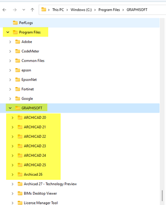

I am guessing that you have a license for Archicad 21 but also have a newer version of Archicad installed for which you do not have a license.
If you simply open this file, it is opening in a newer version for which you do not have a license, but the .PLN file type is associated to this newer version.
Launching 21 and browsing works just fine because you have a license for 21.

Open the Program Folder and have a look how many versions of Archicad are installed.
If there is just one, I can not understand why it would start in demo mode.

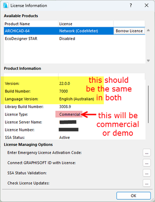

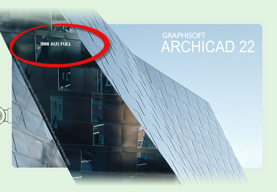

What I was trying to find out is what version does the demo say it is running.
This is my 22 licensed version, but the 'about' screen shows me this ...
And if I check 'License Information', I see this ...
Does the 'demo' version appear to be exactly the same as the licensed one.
Can you compare them both?
Sorry....when i clicked 'Reply' it prompted 'Accept Solution'......anyway, the licensed Type shows 'DEMO'

Yes, but is the version, build and language the same for both?
