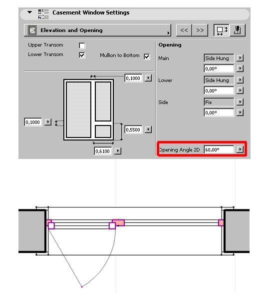

Hello,
I want to have an opening line symbol in 2D (plan) of the windows !
i mean : when i place a window on a wall, the windows symbol appears but there's no line draw when the window is open ! how can i have this symbol in 2D showing an opening window ??
thx for your help
This should do the trick (see attached image).
Cheers.
