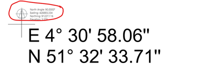

The problem comes when I try to set up the Origin Point (within the Project Preferences). The only units accepted to set up this point are "Degrees/Minutes/Seconds" or "Decimal Degrees"
I have tried to use on-line translators, but I haven't found any that is giving me an accurate position.
Could anybody tell me how to set up an origin point with a eating/northing/elevation numbers in metres?

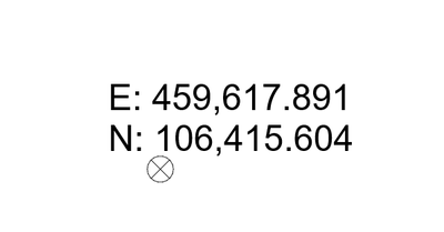

Did you manage to sort this in the end. I'm struggling to find an answer. It used to work on previous versions, but on 27 I can't find a way to change the units in the Coordinate Dimensions Object. Funny is that the SP displays exactly what I need. See images attached.
Hey Tic, I hope you found your solution during the weekend, but in case you hadn't... Please find attached a quick explanation to what I think is your problem... which is the same one I found myself into...
