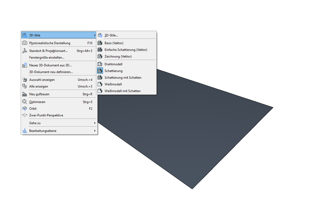

Hello everyone,
I’m trying to apply an orthophoto texture to a slab so it shows both in the floor plan and in 3D. The material is assigned, but the texture does not appear.
Does anyone know what I might be missing or which settings I should check?
Thank you!

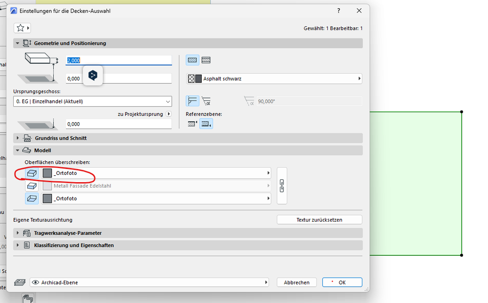

In the Surfaces Dialog, is a texture assigned to this "Ortofoto" Surface?

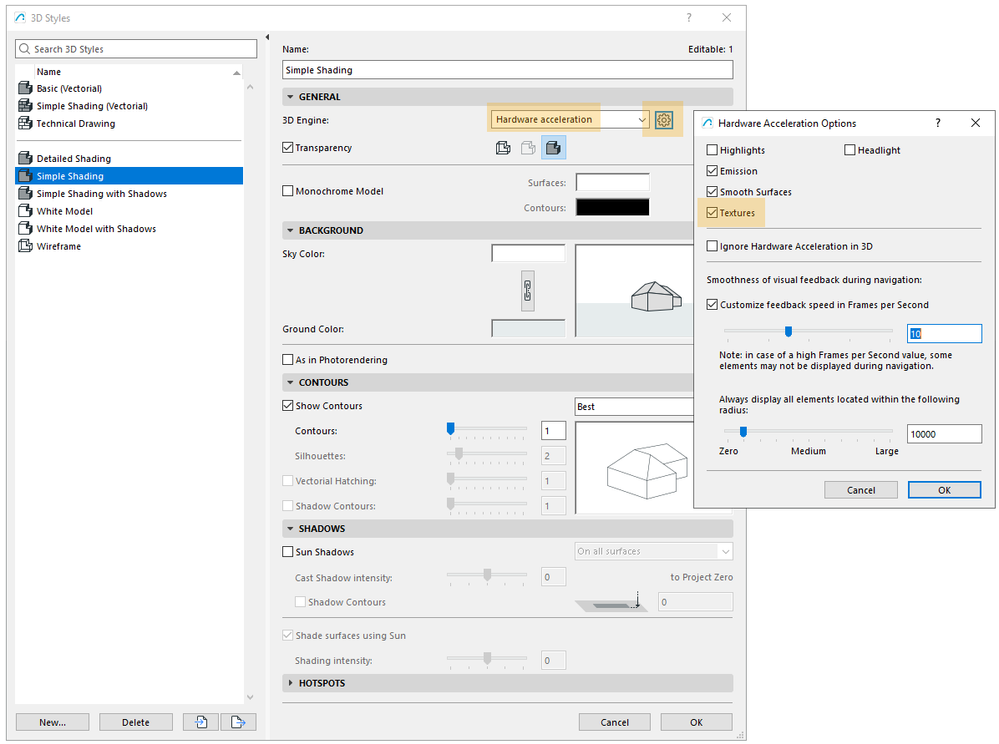

In 3D, are you using a 3D Style that uses Hardware Acceleration? In the Advanced Options Dialog for 3D Engine, is Textures checked?
In the Floor Plan Viewpoint, Image Fills are not available for Cover Fills (they are only available in Sections/Elevations), so you will not be able to display it as part of the Slab. You will have to use the Figure or Drawing tool to place and display an image on the Floor Plan.
