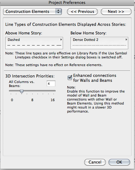

I have those members placed in the 2nd floor, and I configured them to show in HOME STORY AND 1 STORY DOWN but the graphics are the same to both floors, I would like to have them projected in the 1st floor since they are not physically there.
The way around I found is to just duplicate information (which I hate to do) and have the trellis traced with dashed lines in the 1st floor. If any change is done to the trellis I need to remember to go back to the 1st floor and change dose traced lines. (Not only this is not productive but also it gives chance for errors.)

Try going to the options menu, project preferences, construction elements. You can change the line types there.

Thank you Stephen,
This is the way it is configured but it stills not showing the lines projected in the floor bellow. Any idea of what the problem could be?

Sorry-I thought that would do it. No other ideas. What tool did you use for the trellis?

beams

If possible, try a slab or a roof. They display correctly
(dashed lines) on stories other than home story.

You can try this part that I am writing specifically to do trellis'. While not yet complete, it works fairly well.
It has an option to change the line type on the level below the home story.

Waw this is perfect!! How do you built this? in ArchiCAD?
