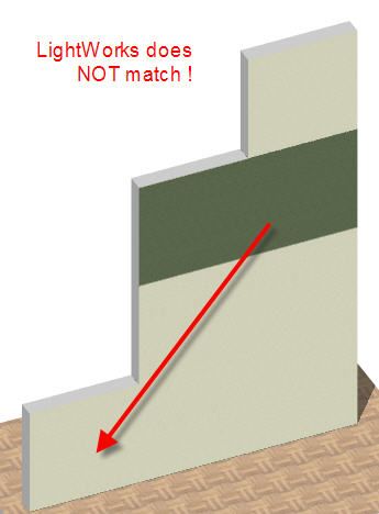

Look at the attached image generated by LightWorks. A bit of a problem, eh? The “Match with Internal Engine” button is clearly doing the wrong thing. This is a known bug.
(Continued in next post…)

Ransom Ratcliff (AEC Infosystems / Baltimore) brought this “Match with…” problem and a solution to my attention. (Ransom makes uncountable contributions to the ArchiCAD community - Thanks, Ransom!)
To make the LW material match the internal/OpenGL material, click on Texture Space as in the attached screenshot, choose St Layout, then select T Reflect and change it to “yes”.

After that correction (temporary bug workaround), the image from LW appears correct as seen in the attached.
