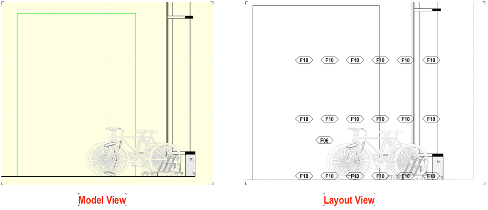

Nathan wrote:
some earlier placed labels are lingering on the elevation in layout view only, despite having eliminated the object and the label in the model. When I open the view, and show all layers, the offending label is nowhere to be seen.
We're getting a little off topic from Nathan's original post. I'm seeing this issue too, for the first time and think it's a v12 bug. In my case, the labeled elements were deleted in plan and the elevation view was moved to a new location (also in plan, obviously). Yet the labels persisted in their original location when viewed in the layout.
Creating a new elevation appears to fix the display problem. The issue seems to have to do with moving the elevation that includes labels. It's very disconcerting when the layout does not match its linked view. Ugh!
