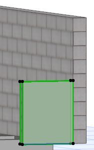

I have similar problem in that the entire wall is selected. furthermore, the Pet Palette is not displaying all the parameters.
what I am trying to accomplish is to create a 45 angle concrete buttress wall to a block wall. I am totally lost if the Pet Palette won't open all the way.
ArchiCAD 15
ArchiCAD 15
The pet palette displays a different number of buttons depending on whether you click on an edge or a node. It may even vary depending on which node you click on! This is because some ways of modifying geometry are not applicable to all geometry types, so these buttons are hidden where not needed.
If you are looking for a button to try to adjust the height of the individual nodes on that wall - you wont find one as walls can't be adjusted like that! Instead place a single plane sloped roof over the top of the wall and use either 'Solid Element Operations' or the 'trim to roof' function to trim off the top.
