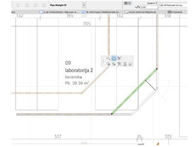

When modeling horizontal pipes, it is possible to use the "Offset Edge" command to move the desired pipe so that the fittings and other connected pipes are automatically modified, in the following image that shows how it would look.
However, when the modeled pipes are inclined, if the same command is used, only the selected pipe is moved, that is, separated from the rest, in the following images of that case.
Is it possible to achieve the same effect as with the "Offset Edge" command in the case of horizontal pipes by means of certain settings or by using some other routine during this type of editing?

Hello,
Thank you for sharing your idea!
I'm glad to say that we took notice and we have added this wish into our Wish list database.
(For future reference, you can refer to it as IDEA-12241)
I hope we see this get implemented in the future.
Have a great day!
