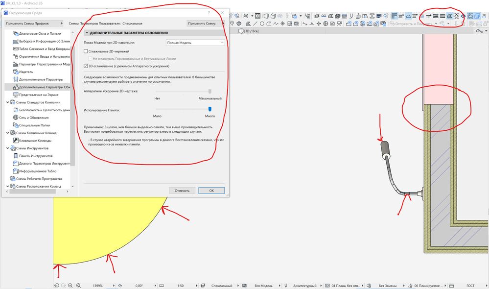

Poor drawing graphics in version 26
The display of drawings has become much worse compared to version 25.
Attached are comparative screenshots of versions 25 and 26 in different versions of line widths.
The line thicknesses in version 26 are coarser, blurrier and thicker. In version 25, the graphics are crisper and neater.

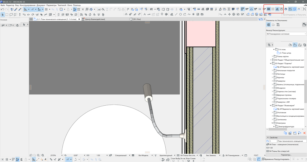

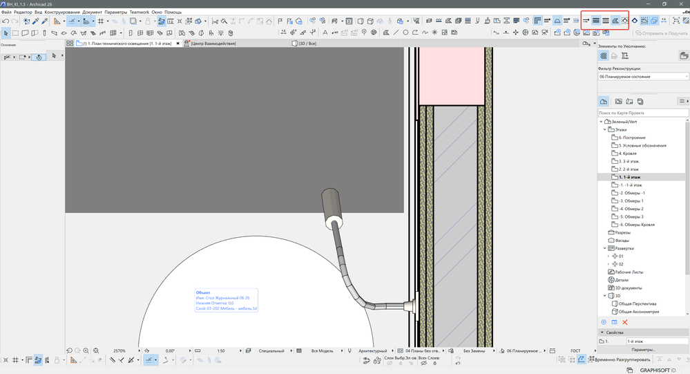

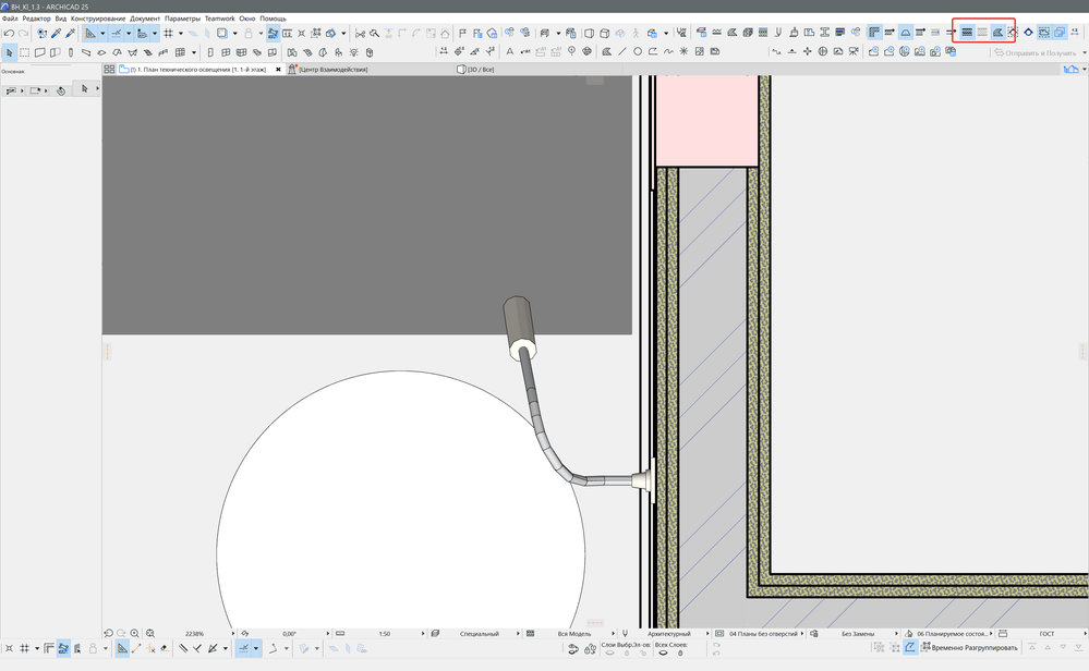

Tried different modes of combination of parameters: monitor (4K 27'), line thickness display settings, with anti-aliasing enabled in 2D.
1. When scaling the font size 175% and enabled anti-aliasing in 2D - displaying graphics as close to version 25 as possible, (more accurate and familiar in my opinion) but the blurriness in version 26 is more.
2. When scaling font size 200% and smoothing in 2D is turned on - displaying graphics becomes much thicker and clearly blurry with the blur effect compared to version 25 where everything is unchanged and looks neat.
