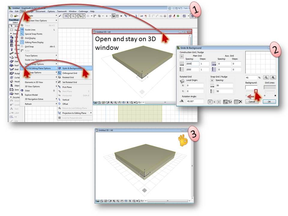

just turn it off from the Menu: View / Editing Plane Display.
or try this...

Thanks for the second option NandoMogollon. I tried the transparency and it worked fine for that window but when opening another 3D window the transparency resets itself and I have to repeat the process. I wonder what could be causing this to happen?
rocorona
That is not a good solution. I suggest to keep the transparency ON, and set OFF the visibility (View Menu).
In the Work Environment > View Option (or similar) you ave another checkbox to choose if the editing plane will be always visible, or only during the editing work.
