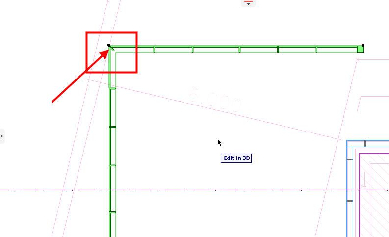

I am facing a problem while using Curtain Wall Tool, I am trying to delete the Corner Frame in Curtain Wall (See Image).. I tried this in 3D Editing but it doesnot allow me to do so.. Please Suggest any Solution!

AFAIK it is not possible to delete the perimeter frames of a curtain wall. The best you can do is make them very small.
You'll have to play around with it but you can cut the curtain wall with the trim-to-roof tool. I've only done it a couple of times but it's how I got rid of the outer frame members on curtain walls.

hemanayal:
I was able to get close by doing two things:
1. In the 3D Window, select the corner frame and change from Generic to Invisible, this will eliminate the frame in 2D and 3D.
2. Select the Panels and change from Generic to CW Corner Panel. Then change this to One Butted Edge and play with the settings until the panels overlap at the corner.
