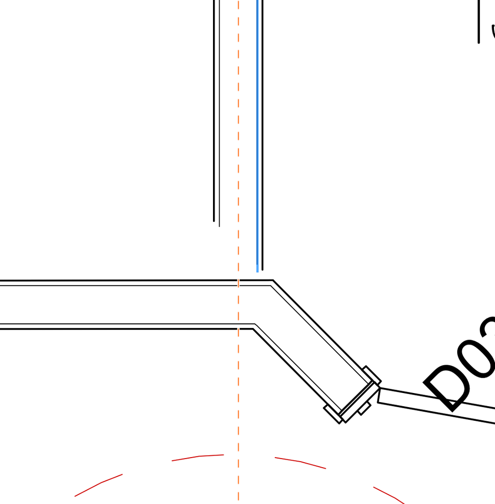

Hi I have a problem occasionally when joining three wall. It always seems to happen when one is at an angle, I can never seem to get the third to display properly and it especially happens when I'm trying to connect at the angled joint. See picture below. Thanks, and sorry if this was already answered in a prior thread.

Make sure that the reference line of the horizontal wall is at its top on the image, and the reference line of the diagonal wall is at its right side on the image.
Ivan Myers
Thank you Laszlo you quickly becoming my ArhciCAD Mentor and hero!
That was the problem.
