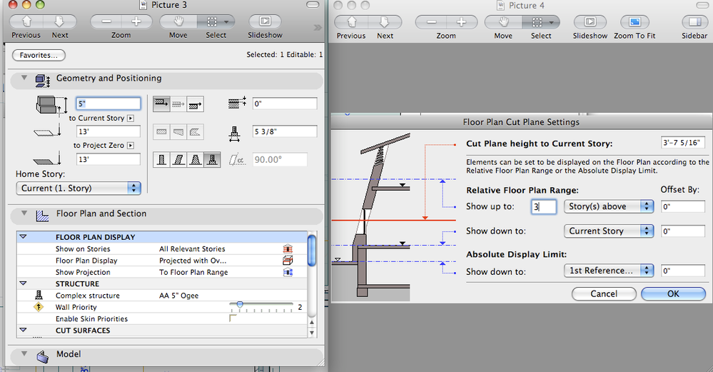

Problem - wall does not show in slected floor plan range
I am not able to make this wall show above its own floor. Are my settings correct ?

In the Floor Plan Cut Plane Settings Dialog, try to set the Show Down To value to a lower value, such as -4' or something.
What is your Story Height on Story 1? Because the value needed will depend on that.
Thanks Laszlo
The floor is at 17 ft but the element I try to place is 3 ft below the floor like a roof object on a lower floor I need to see on all foors from here upward.
Set the Show Down to field to Story(s) below and in the appearing text field on its left, write a value of the difference between you highest Story and Story 1. So if your highest Story is Story 4, you would enter 3.
That should work.
Thanks it works but the logic is not transparent in the interface. The interface should state that id considers a default view from the top story downward
