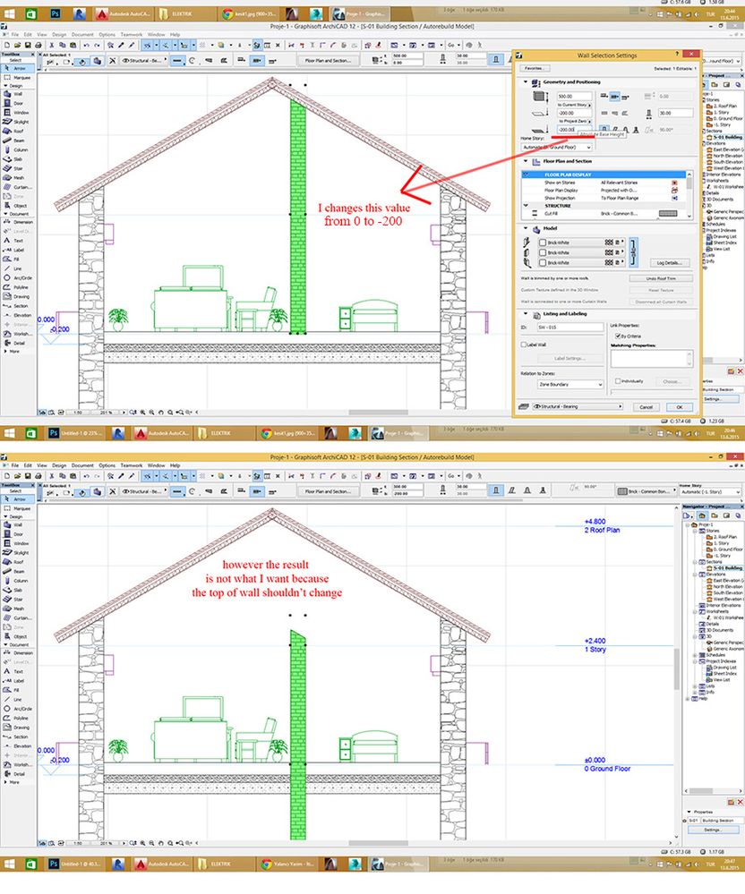

Problem with changing the base point of the wall
I want to pull down the start point of a wall in my project.However when I do this the upper part of wall also pull down.How can I solve the problem thank you

I tried this but again same.This is very annoying.How can I solve this problem.Thank you
The problem is that you have probably trimmed the top of the Wall with a Roof. When you do this, the program stores the position of the trim relative to the Wall base. So if you lower your Wall the trim will also go lower.
You can do one of two things:
1. Undo the Trim and then Trim the Wall again with the Roof. In this case you will have to redo it if you place the Wall to another location vertically.
2. Use SEO, which creates an associative relationship between the Wall and the Roof that cuts it. In that case when the Wall is relocated vertically, the cut will update on the new location of the Wall ans Roof relative to each other.

Actually I don't have so much experience in Archicad I am new use.I didn't understand how can undo the trim.
Also I didn't understand what is SEO and how can I use this feature.Could you explain it in more detail by telling the steps.Thank you...
Select the trimmed Wall, go to its Settings Dialog and in the Model panel click the Undo Roof Trim button.
