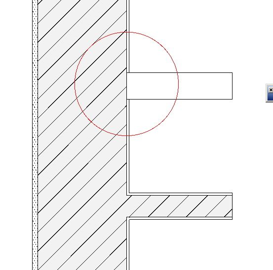

when I have a lower interior wall represented as projected in floor plan, the intersection is incorrect.

Can you change the layer intersection priority number so that it doesn't try to join? If that solves it just remember that you'll need to update all of your layer combos with this new setting.
What are the priorities set for each Building Materials that are in use? I tried to re-create a similar situation, where the wall intersects with a core of the wall, but when I set it to end under the cut plane, the representation showed up correctly.
