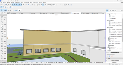

These walls are both set to be all white, but the one on the left doesn't change. Both walls were "cropped" to fit to the roof. I just don't know what to do 😞 Please help

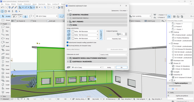

You have a Solid Element Operation acting on that wall. Check to make sure you are not removing the outside face of your wall and revealing the core.
Ling.
Or it was set to adopt the surface of the operator.
Lingwisyer
Guru
Either way, the surface that the override is affecting has been removed.
Not necessarily.
The 'Connection' is probably just the crop to the roof, so is possibly not affecting the face of the wall at all.
