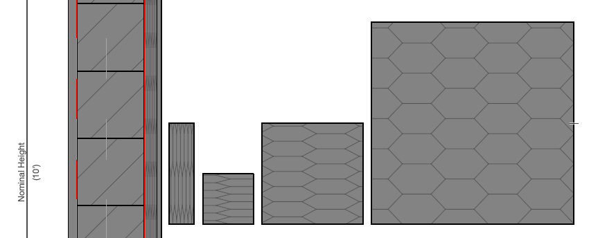

In Profile Manager, I use an Insulation Spray building material, but the same building material/fill changes when it is stretched (shown below).
I want it to scale the fill independently so it shows up as a perfect hexagon. (I scaled independently and scaled with plan, with no impact.)

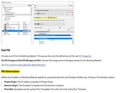

 I wasnt able to reproduce your issue with this vectorial fill...
what happens if you go to the settings of your building material and try different options for the fill orientation:
https://help.graphisoft.com/AC/26/int/index.htm#t=_AC26_Help%2F025_Attributes%2F025_Attributes-17.ht...
