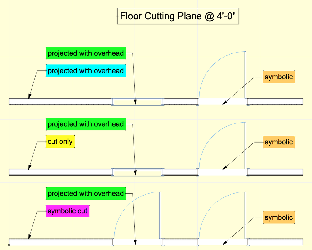

For the purposes of creating multiple views using different height cut planes, I need to use either projected or projected with overhead doors. In the attached image, those doors appear in the closed position when used in either projected with overhead or cut only walls. They are all set to be in the 90 degree position, so something is not working as expected. Can someone please confirm that there is an issue with these doors not displaying correctly?

Did you set the opening angle to 90 for the 3D view of the door? The "projected" views are real projections of the 3D geometry of the object.

Mille grazie Roberto! The door swing line must be added manually, but otherwise problem solved. Scott
