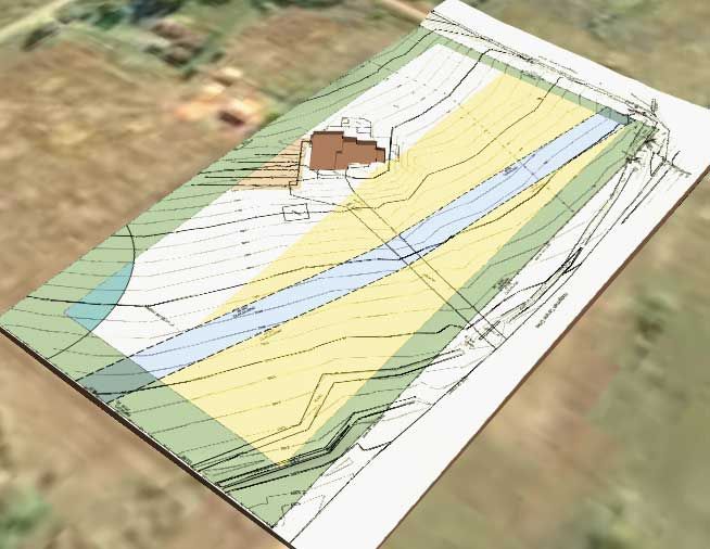

Another option, for renderings only, is to create a texture in Photoshop that exactly overlays your site mesh and includes the property lines as part of the texture. (I assume you want the lines for 3D - since 2D works with just linework.) See attached for an example - super gradual site, but technique is the same. I've done something similar on steep sites, but not with the detail shown in this one. Here, the texture is the actual survey painted up in Photoshop to show setbacks from the property line (green), waterline easement (blue), county non-buildable "front yard" (yellow), septic drainfield (brown).

Here's a steeper one from 2002 ... (Reminds me of how much I've learned since then!)
Here, the grass texture shows the allowable buildable area (could as easily have been lot boundaries/etc of course). That bit is actually a mesh carved out of the first mesh as described in my first post - so this uses both techniques: two meshes, with the greater mesh assigned a texture that maps onto it exactly from the survey data.

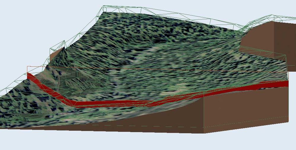

If you really want walls to follow the slope of the terrain, that isn't hard to do ... but you do not want to use trim-to-roof. Rather, you want to use Solid Element Ops.
The attached shows another project site mesh - with a Google Earth texture mapped onto it. This is a screenshot of the OpenGL window.
I placed a red wall to represent a boundary line.
Then, I duplicated both the mesh and the wall, placing the duplicates on a "Hidden Cutting Objects" layer - in this case set to show in wireframe so that you can see them in the screenshot.
Steps then were:
1. raise hidden cutting mesh upwards the desired final height of the walls
2. SEOp subtract with downwards extrusion the raised mesh from the wall copy on the hidden object layer (wireframe)
3. SEOp subtract (no extrusion - pure subtract) the trimmed wall from 2 from the solid wall
Cheers,
Karl

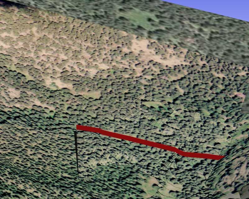

For what it's worth, here's that wall in the larger Google Earth context terrain. Unfortunately, GE terrain is a very, very rough mesh and while reasonable accurate - it is not accurate enough for a precise mesh, such as the last post, to blend in perfectly.
I just learned in another thread that the AC 11 (but not 12) GE Connection plug-in for Windows brings the GE terrain in as an actual AC mesh, which would allow editing the GE mesh edges to blend with the accurate survey mesh - and eliminate the dark shadow line (a cliff!) that you see to the left of the red wall.
Karl
(This mesh was created for Zimtor Architecture, Bozeman, Montana.)
