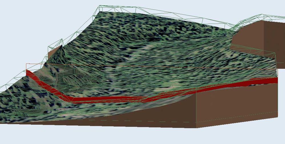

If you really want walls to follow the slope of the terrain, that isn't hard to do ... but you do not want to use trim-to-roof. Rather, you want to use Solid Element Ops.
The attached shows another project site mesh - with a Google Earth texture mapped onto it. This is a screenshot of the OpenGL window.
I placed a red wall to represent a boundary line.
Then, I duplicated both the mesh and the wall, placing the duplicates on a "Hidden Cutting Objects" layer - in this case set to show in wireframe so that you can see them in the screenshot.
Steps then were:
1. raise hidden cutting mesh upwards the desired final height of the walls
2. SEOp subtract with downwards extrusion the raised mesh from the wall copy on the hidden object layer (wireframe)
3. SEOp subtract (no extrusion - pure subtract) the trimmed wall from 2 from the solid wall
Cheers,
Karl

For what it's worth, here's that wall in the larger Google Earth context terrain. Unfortunately, GE terrain is a very, very rough mesh and while reasonable accurate - it is not accurate enough for a precise mesh, such as the last post, to blend in perfectly.
I just learned in another thread that the AC 11 (but not 12) GE Connection plug-in for Windows brings the GE terrain in as an actual AC mesh, which would allow editing the GE mesh edges to blend with the accurate survey mesh - and eliminate the dark shadow line (a cliff!) that you see to the left of the red wall.
Karl
(This mesh was created for Zimtor Architecture, Bozeman, Montana.)
