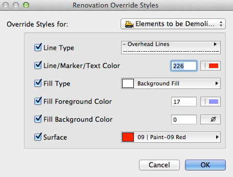

I have tried to set my renovation filter to show my demolished elements as transparent but with a red dotted outline. For some reason, the demolished elements now show as a solid background fill which is contrary to the graphics in my renovation filter options.

Look at the settings under Renovation Override Styles... (button at lower right in your screen shot). You probably have the wrong settings for Elements to be Demolished.

griggadee
Hi David,
Thanks for the reply. I have tried to changing the settings but to no avail. Here are my settings:

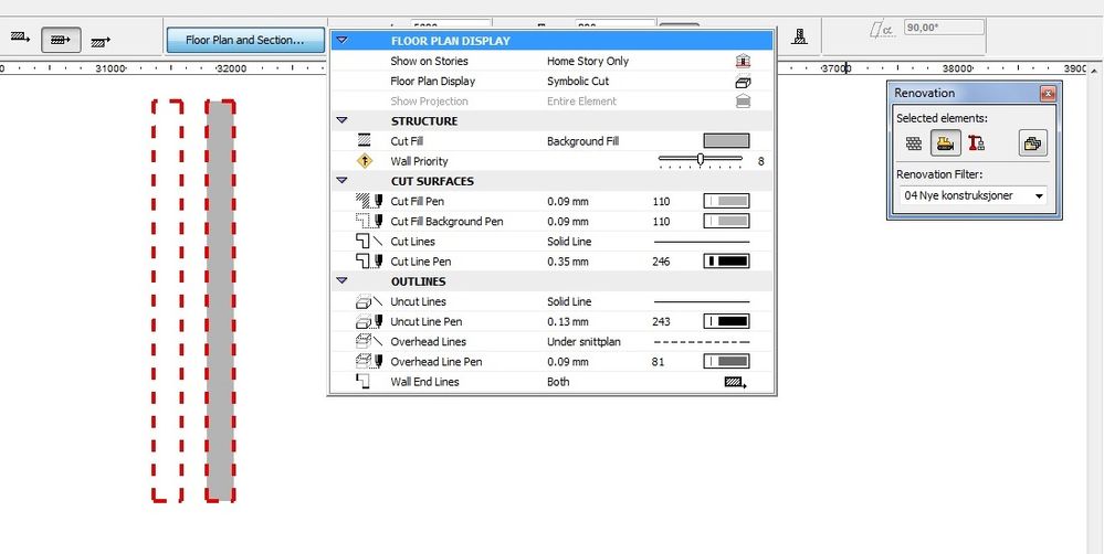

The only manual workaround I can find is to change the Wall Selection Settings manually to change the background fill from grey to transparent. This works, but defeats the object of having an override set up in the Renovation Override Settings which automatically makes all demolished elements transparent with a dotted red outline.

griggadee
Wall Selection Settings.
See post below for my current update.

Uncheck "Material" (or change the material) in the Renovation Override Styles dialog box.

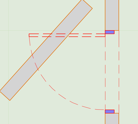

I cannot reproduce what your screen shots show, so don't have a solution for the wall fill issue. In Screen Shot there appears to be a door under the red dashed outline wall, are there elements on top of each other? In Screen Shot 2 there is a dashed window in a filled wall, is this a window or lines? You could try copying some of the demolition elements to a New & Reset file to see if they behave, maybe the file you are working on has some corruption.

There are no elements on top of each other, the door you can see is a PDF within the drawing for reference.
The window in Screen Shot 2 highlights a very good point actually. It is an existing wall with a window to be demolished in it and that is how it looks when I allocate the 'To Be Demolished' renovation status to it.
I have resorted to manually changing the properties of the walls which then seems to appear correct, but I am aware that this defeats the whole point of the renovation status tool. I am now tempted to go more old school and simply put my to be demolished items onto a separate layer and then hide them and replace them with manually drawn red broken lines.
