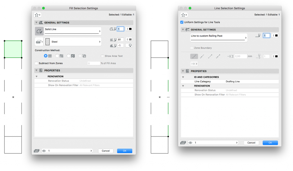

Create the 2D Symbol
  1. Select and then Open your Railing Post object in the GDL Editor with 'File/Libraries and Objects/Open Object…'
  2. Open the '2D Symbol' tab/window from the left side and draw the desired symbol with the basic 2D tools (Text, Fill, Line, Arc/Circle, Spline and Figure Tools).
You can use the Hotspot Tool to aid you to draw the symbol you want, but the Hotspots won't be shown on the 2D Symbol, and you won't be able to use these points for adjusting elements, snapping dimensions, etc.

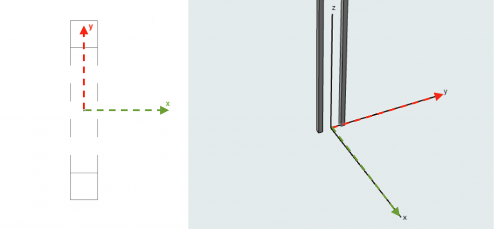

  2. Make sure the geometry is properly coordinated, same as in the 3D. In the '2D Symbol' tab/window the X axis points to the right and the Y axis points to the top. So, in this case Y axis should be parallel to the reference line of the Railing, and the origin should be in the middle.
  3. Close the '2D Symbol' tab/window.
