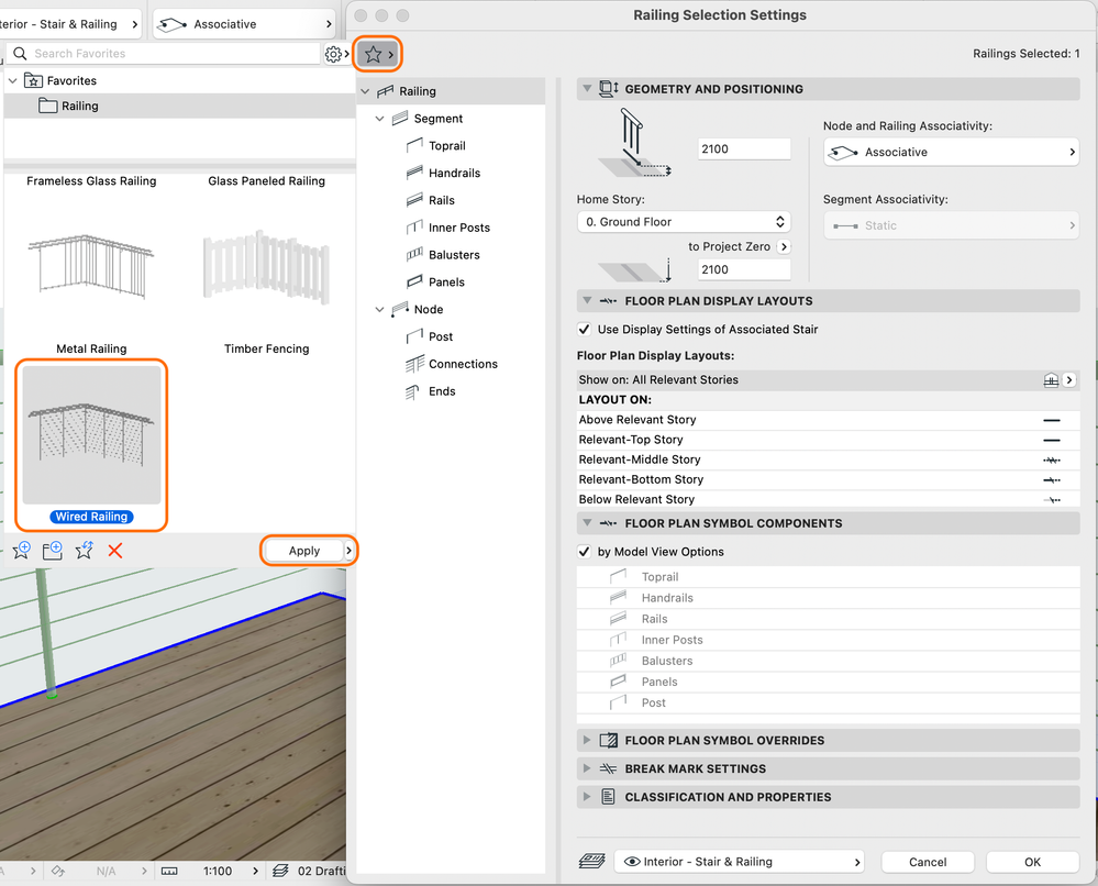

Before we get started: remember to ‘Favorite’
Favorites are used to save and apply frequently used Railing settings configurations.
Favorites are stored in the project file and can be imported or exported between projects. They can be accessed and applied directly from the Railing Default Settings dialog:
Saving an empty railing as a Favorite is recommended for quick setup when starting new models.

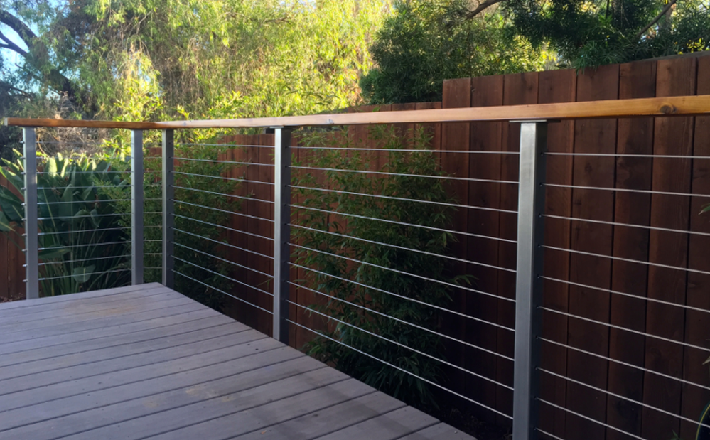

Railing A: horizontal cable runs
  1. In the International template, the Favorite “Wired Railing” can be used as a starting point.
  2. Set the height of each cable element, adjust the thickness, profile, and material accordingly.
  3. Likewise, set Inner Posts for intermediate spacing – dimensions, profile, material, etc. When the Equally Distribute Pattern (max. length) option is enabled in the Segment settings, the optimal spacing of the intermediate posts can be defined.
  4. Set the end posts for corners. Ends settings can also be adjusted to control how far beyond the last post the Toprail projects.
  5. Adjust the fixing of the Toprail.
  6. To achieve a realistic detail in the corners, set up Connections for the rails.
  7. Finally, adjust the position and height of the whole railing and fixing solution at the bottom:

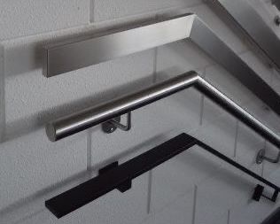

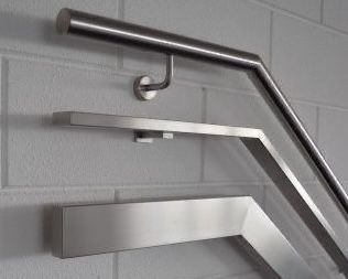

Railing B: wall mounted handrail with brackets
Source: https://br.pinterest.com/pin/1618549861730713/ .
  1. For such cases, a Handrail with wall fixing is used.
  2. The fixing distribution settings can be customized in a dedicated tab. In this example, the railing does not contain any posts, therefore we should use either the distribution by number of divisions or by pattern (pre-defined distance).
