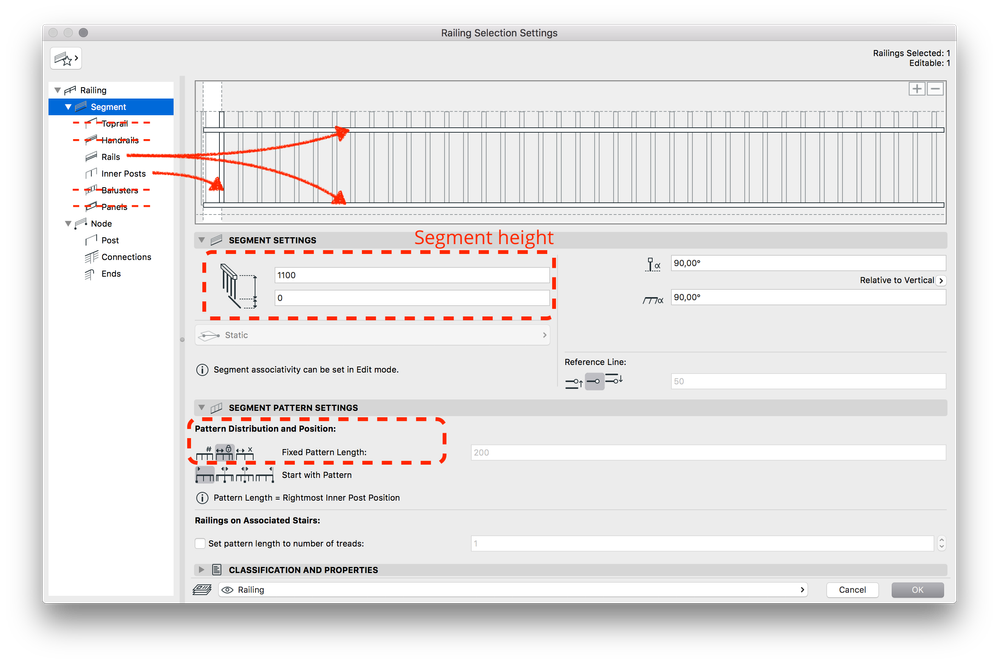

Create a Railing to use the Post:
  • set the segment height (in this case 1100mm)
  • use Fixed Pattern Length distribution (this way it will be controlled by the distribution of the Inner Posts)
  • add a default Post and two Rails
    • Posts will be the Newel Post 21, customised to fit what we prefer
    • Rails will be standard rectangular Rails (in this case 50x15mm) set to the height of 100 and 900 millimetres

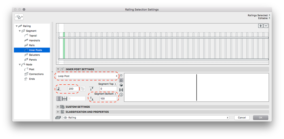

  • set the custom Posts as Inner Posts
    • choose the custom made Post
    • set the distribution value to match the pattern of the Post
    • give the Segment Bottom and Top a value if needed (in this case the Inner Posts are sitting on the bottom Rail, so it's set to 100mm)
