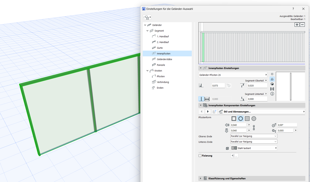

no matter, how I change the distance betwen the posts, it always remains the same. Anyone knows why? railing postsrailing posts

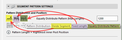

Go to segment and look at the pattern distribution of the segments.
There will be an inner post at the end of each segment and a main post at each node in the railing.
