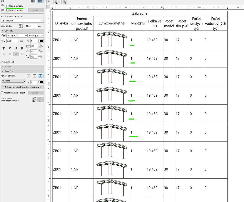

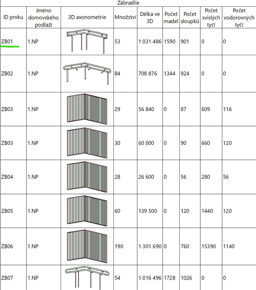

The preview is not the main problem, problem is in the numbers of railings (4th column - sorry I have czech version). I have just one railing ZB01 in project, and in 4th column, there is showing that there is 53 pieces. I dont know why.

It will give 53 rows of ZB01 railing, but it just don't make sense, because in project I have just one ZB01.

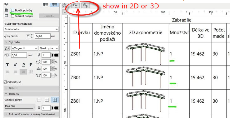

Seems like I will have to draw them all in 2D and make a 2D table. I tried to ease my work. Shame it doesn't work right. But thank you anyway Barry.

Maybe there are multiple copies in exactly the same place.

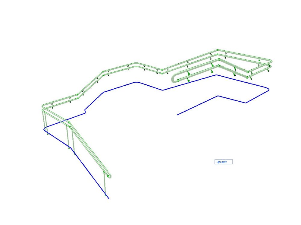

Select one and show in 2D or 3D.
Delete it and see if there is another still there.

Can you show us a screenshot of the Scheme Settings you used in the Interactive Schedule? I think you used the Components Schedule, and most probably it is counting every sub-element of the railing. Try to create an Elements Schedule and filter by Element type = railing only

Okay, I tried to play a bit with the Components schedule for railing. I modeled a simple glass railing with fixings. Glass panel with the fixing option turned on. It looks like Archicad schedules can't recognize what are fixings what are panels. My railing had 9 glass panels. In the schedule it wrote 18. When I turned off the fixings options in the panels definition, it sad there are 9 panels. So it looks like a bug. Probably it counts every fixing in your rail and handrail, too. Check it out and tell us. If it is so, it is a bug.
