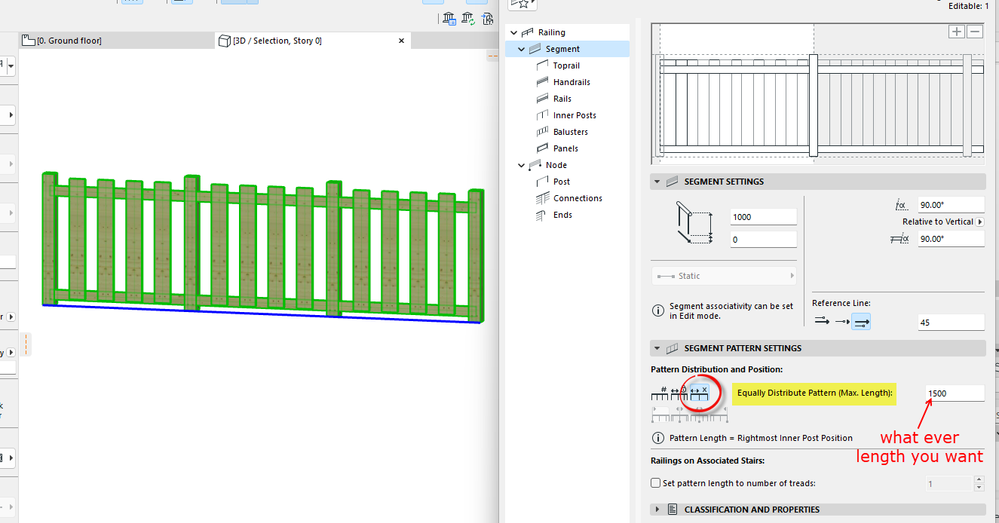

@RafaelPretti  schrieb:
The paling should cover the posts and inner post

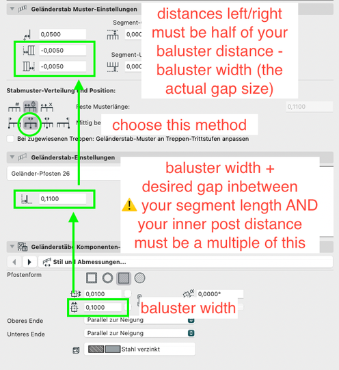

So if I understand you correctly, you want something like this, where the balusters run in front of the inner posts and are equally distributed over the whole fence?
Okay, we need some math:
So e.g. if your baluster is 10 cm wide, and the gap is 1 cm, and you want 9 of them until the next inner post comes, then the segment length and inner post distance must be set to 9*11=99cm. With an odd number of balusters you need the method I checked in the picture, if its an equal number, the other "center" one.
Actually not that hard but I agree not very discoverable. Once you know you know.

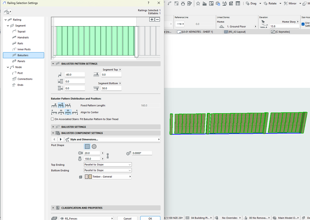

HI @runxel
I tried the same approach as you did and although it works well when the distance between inner posts are at the maximum, as soon as the distance is smaller or there is a "corner" there are gaps on the model.
Any idea how to fix this? I tried so many different ways but wasn't able to get to a perfect result.
I modelled exactly the same fence as you did, and those same gaps are still there (images attached).
Thank you

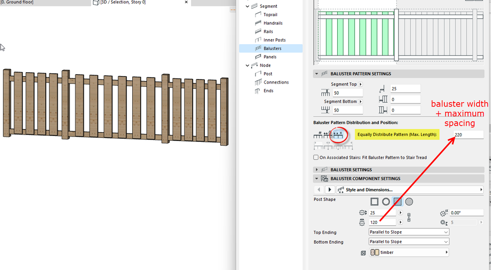

Try setting the balusters to 'Equally distribute' and set the max length to the baluster width + the maximum spacing you want - in your case 160mm.
You can also set the segments to 'Equally distribute' as well and you won't get segments with different baluster spacing because of the different segment lengths.

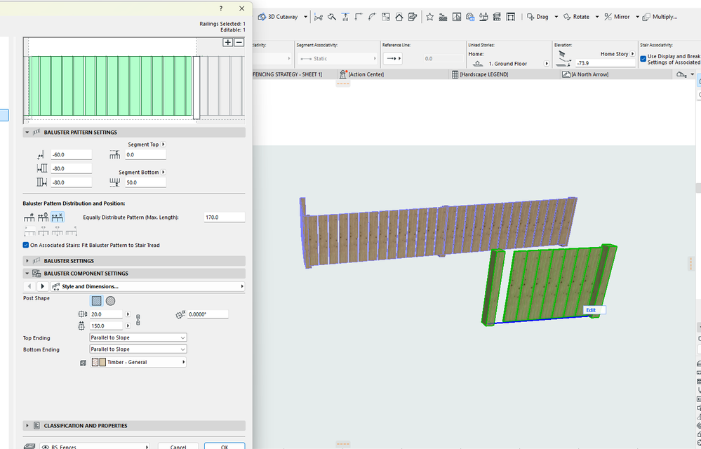

Hi Barry,
I had tried this approach as well with equal distribution on both segment and baluster settings.
Although it seem to be the best one so far it still has some issue whenever the length is smaller then the "max. lenght".:
Please see below 2 screenshots, on of them you'll see that it works pretty well, even at the corner. But on the second one, with a lenght of 1420mm, it has those same gaps between balusters and posts (it almost seem like whenever there are no inner posts/segment on the object archicad has a hard time creating the model):
Thank you

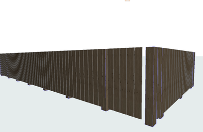

I'm adding additional nodes, its the same railing "object".
I did think about just adding an additional railing for every turn and just keep them as straight lines but if I have a smaller length (see my reply to Barry above) then the gaps seem to appear once again.
Try adjusting the end offsets.
Zero doesn't seem to work but something like -30 might be better.
You may need to edit just that particular segment rather than the whole railing, and you may need to add nodes to break it into smaller segments.
Seems that there is an allowance for a post space even when there is no post?
I can't figure that one out.
