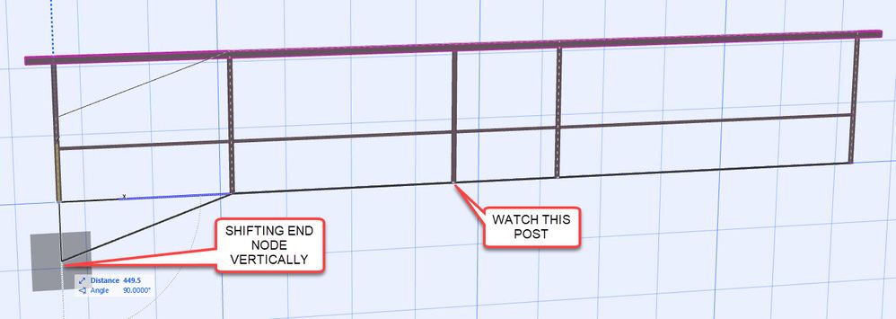

I have encountered what I am pretty sure is a bug in the railing tool...but I could just be missing a setting. Steps followed:
1. Create a straight static railing with 4 nodes, including the end nodes.
2. Change one end node vertically.
3. The post next to the 'bent' node will disappear.
See series of screenshots below.

Move end node vertically

Bruce
Post disappears, but node remains. Cannot re-insert post onto node - option not available

Bruce
New node inserted. Post appears at old node, but not at new.

Bruce
New node added on other side of working node - post appears as it should.

Thanks sinceV6 - I've seen Eric's videos, which are a good resource. However, these are not Segment: Inner Posts, but Node: Posts. They should appear at every node.
If the handrail is cranked in plan - no problem. If there is no vertical crank - no problem. As soon as you bring the nodes in line so they form a straight handrail in plan, with a crank in the vertical plane, posts will start to disappear.

Do you have the latest update for Archicad?
I just had a quick look in build 5002 and I am not seeing the problem.

Bruce
I have updated to 4022 NZE (the latest for my region) and it now works ok.
